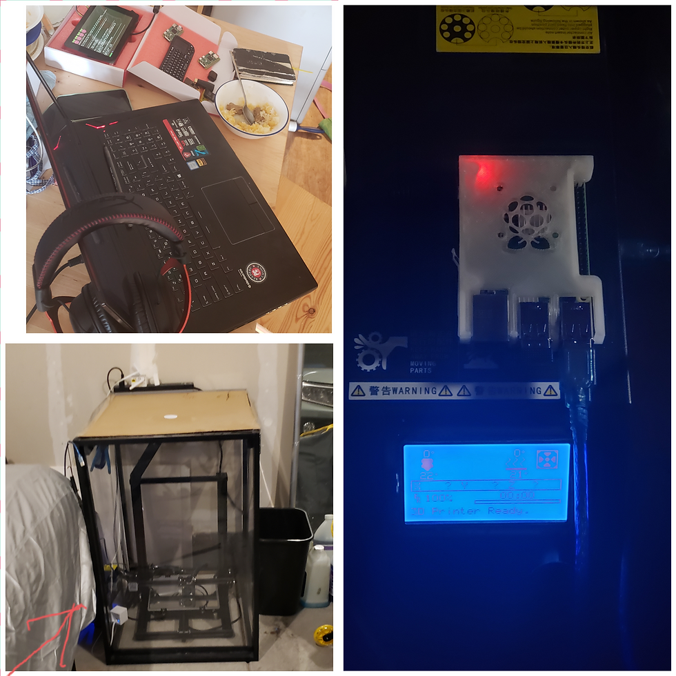

So far with the Raspberry pi I experienced the ultimate sweetness of controlling my 3d printer entirely from my phone! Moving the bed, changing nozzle heights and bed temperatures.
If you notice in the bottom left picture my set up is awkward. My control box is on the floor in a hard to reach spot. The Pi is a huge help and I can use my printer with out noticing this inconvenience.

I printed the case for the Raspberry pi so you can't see it but its a 3b+.
