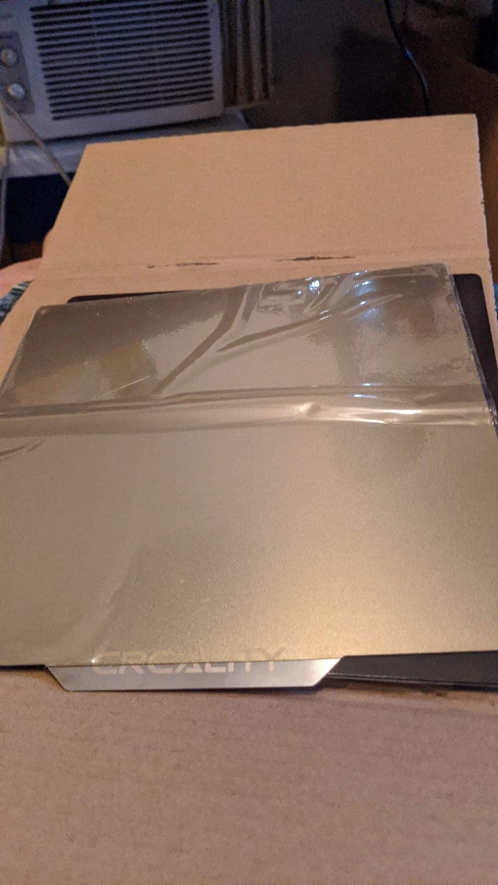

To solve the bed issue, I went back to my wishlist for the ender i wanted in the first place.
Creality to the rescue with their PEI flex steel build plate designed for the ender 3.

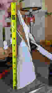

My current project. Pyramid Head from Silent Hill. A wonderful model, again, found on thingiverse. I scaled this dude up 132.41%. printed before new build plate. Sliced to be printed in 6 pieces.
A piece of Pyramid Head that i started before the repairs. You can again, see the layer lines, delamination, shifting, all kinds of things. Most was caused by the slip in the Y axis, while other issues were caused by the firmware. This is the exact point i was fed up. After fighting and fighting to get anything to adhere to the stock build plate, i managed to get this one to stick, but the printer Longer3d released as a working product, wouldn't even keep time. i actually cancelled this print.
And the after repair reprint. This skirt came out great. I printed this at .16 layer height and Exclusive slicing tolerance. Compared to the first one, the creases are much deeper and you can make out the outline of PH's legs.
His sword. 235cm tall after all said and done. His left hand and the sword were in one stl, so i split them and manipulated Cura's "fuzzy skin" effect to kind of bring out the rust and whatnot on his sword. After sanding, it looks awesome. This was the flagship print after reworking the firmwares.
Here's the progress thus far. Still has his right hand cargo to print. but he's looking amazing, even before paint.
