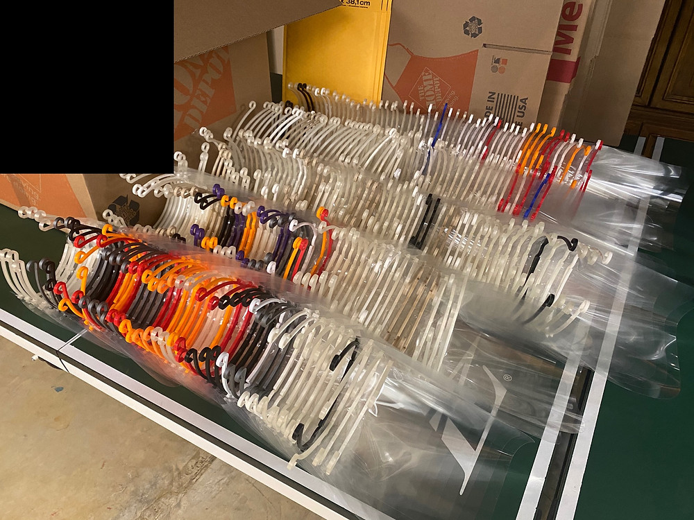

One might say we have a soft spot for Creality printers but that could be an entirely different blog post. We slice almost entirely with Simplify3D, and are constantly perfecting our profiles. When we aren’t selling in our Shopify store, we are going to local craft shows. Unfortunately craft shows aren’t an option with the current COVID-19 crisis, so we donated our efforts to printing PPE for the month of April. We printed just over 2000 of the 3DVerkstan face shields.

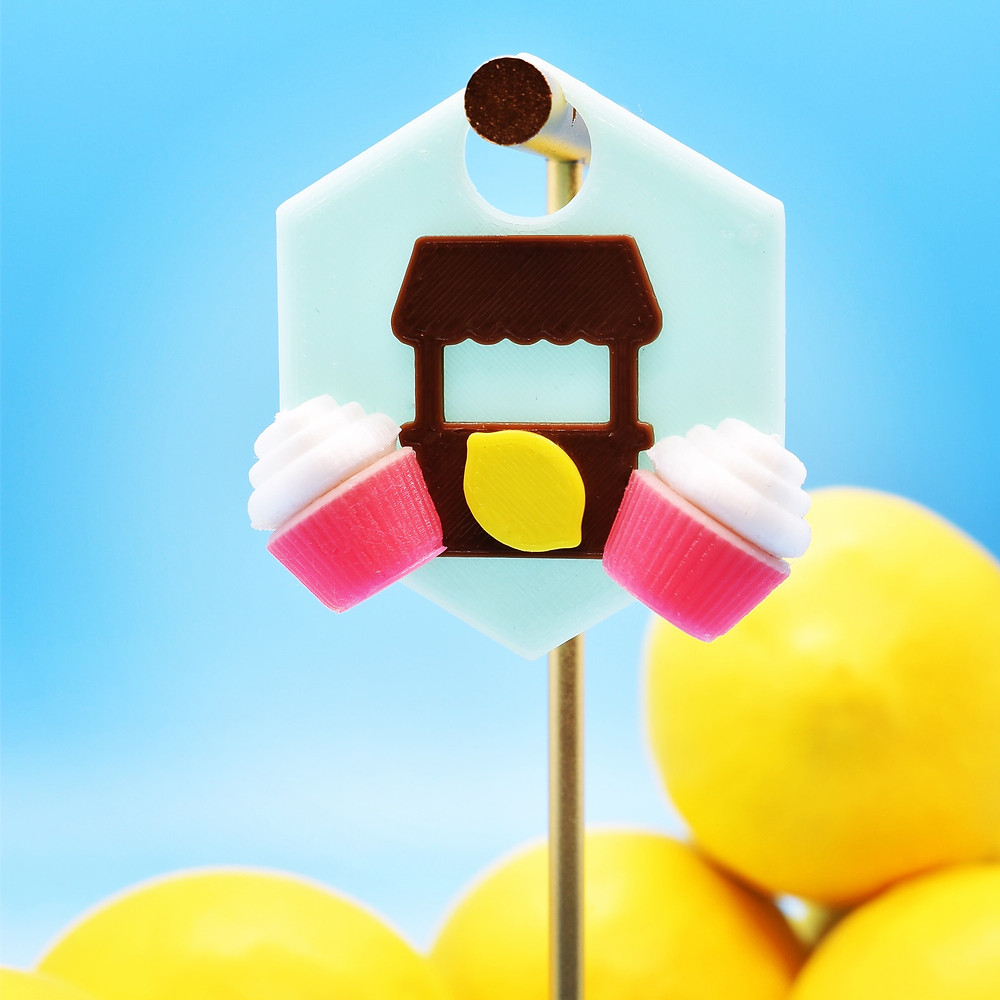

Multicolor 3D printing has been around since the conception of the RepRap movement but it has required stopping at a predetermined Z height and doing a color swap. Firmwares like Marlin have conveniently added GCode to assist with this process. The cupcake earrings (or as we call them stud muffins) were printed with this feature using the Prusa MK3S and GCode based color change. This is the cheapest way to get multicolor, but it doesn’t come without its limitations. This would require models to change color only at specific Z height and limit the orientation of the model.

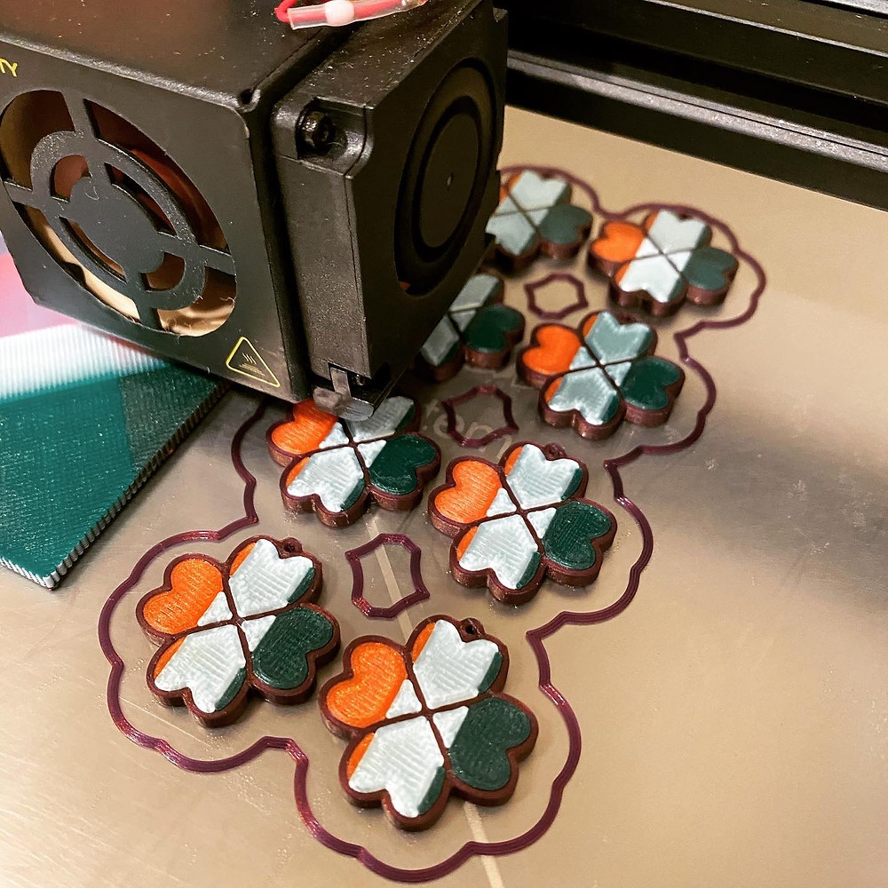

Specifically the Mosaic Palette works by cutting, splicing with heat, and feeding a continuous line of filament to your 3D printers extruder. The Palette comes with a web based software to upload, slice, and even paint your models. Prints can be run in an accessory mode, where you place a file on your Palette’s SD card, and GCode on your printer. Alternatively it can be run in connected mode with a install of Octoprint + a suite of custom Mosaic plugins. There are advantages of running in connected mode however due to the Palettes ability to control your printer, it can perform what they call Ping/Pongs to constantly calibrate the amount of filament being produced and the accuracy of the splice locations. If you have a calibrated extruder (E Steps), you can achieve some stunning results.
Let’s talk about the color change. In order to perform the color swap, a purge block is added by the Palette’s slicer to purge the nozzle from one color to the other. The more complicated the print, and the more colors that are used, the larger and denser the purge block is. For this print of Bruni, the purge bloc weighed more than both of the models combined.
One thing to note however is the number of models you print does not affect the size of the purge block.
