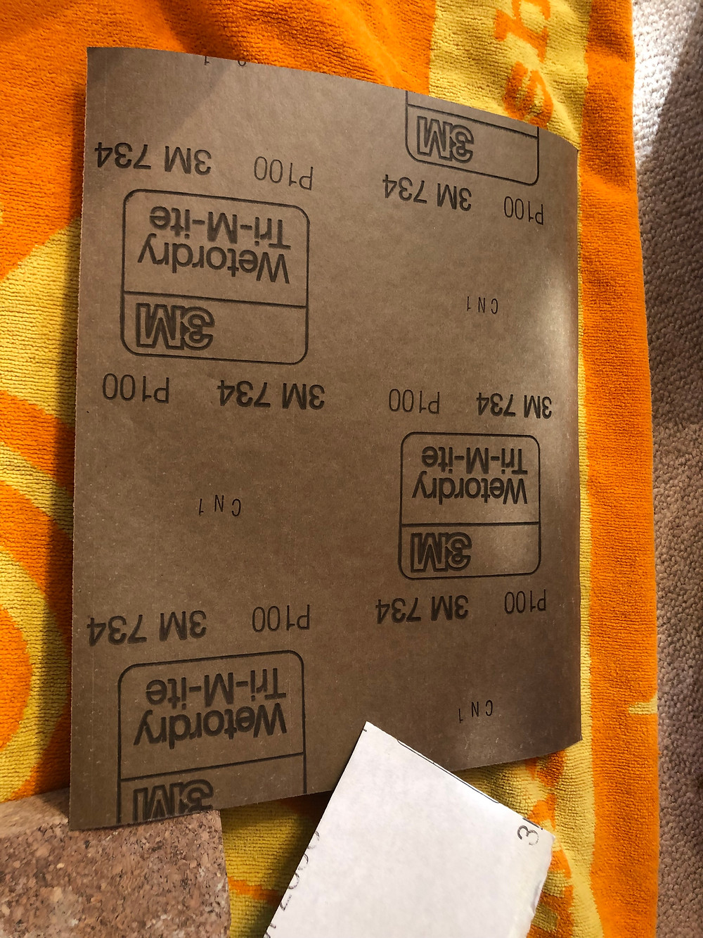

90-100 grit wet and dry paper

you can see the print was done fast at .3 it has quite a bit of ghosting, so it going to take some work, a good going over with 100grit wet and dry and a lot of water (don't use an electric sander with water!!)
use a sanding block, and also wear gloves as 100 grit will take your finger prints clean off!
