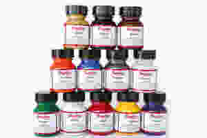

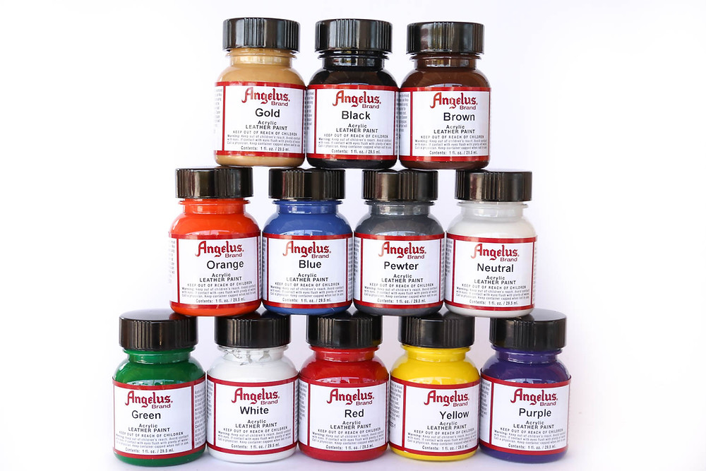

Painting
Due to the flexible nature of the completed parts, we could not utilize the same painting process as the rest of the suit. We have great luck in painting cosplay parts that require flexibility with Angelus leather paints. This acrylic paint stays flexible and wears much better than most acrylic paint.
We custom mixed these colors to match the rest of the armor. The result is "close enough".

When it comes to finishing flexible prints, your use of Angelus leather paint is a great tip. I’ve also seen success with fabric paints and flexible automotive coatings for durability. If you’re looking for inspiration on how flexible materials can be used creatively beyond armor, checking out argan bedaya photos might be interesting. While it’s not directly related to 3D printing, it showcases how flexibility and design can come together in practical applications. Would love to hear if anyone else has tried different post-processing methods to improve the look and longevity of TPU prints!

Thanks the tip about using leather paint for tpu parts. I will definitely order a small pot and try it out on my mk39 build.
