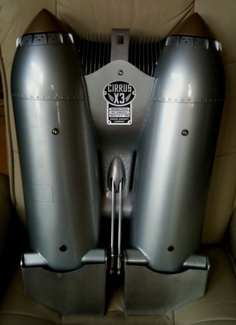

The Cirrus X-3 tank tops have a slight geometry error. It appears the ring of raised elements shifted off-axis a bit and is now presenting a bit of geometry that cannot be easily supported (unless you have a large powder based system that doesn't need supports - unfortunately the tanks are JUST a bit too big for the Formlabs Fuse1 so I have to use the 3L and it is complaining and won't let me print). This would be a quick fix and re-post for the original modeller (and hella hard for anyone else to reverse engineer their STL welded file) so I posted a comment on the listing. NO RESPONSE. Does anyone even monitor these? In any case hopefully someone is reading the forum postings. See images explaining the issue attached.
See the detail of the issue below:

Are the push rods being modeled?
See below for picture of push rod details as noted in the previous post:
Also please note that the ridges on the deflector plates are proud of the surface, not recessed as in the current model.
Thanks, got it. BTW are you adding the push rods for the flaps that are missing on the current model?
@jerome We are pleased to let you know that this problem has been resolved. We will send you the updated file shortly. Please see the image below.
Ok - btw I am 90% done printing the current version - just need the top of the rocket fixed to finish
Hello, sorry for the delay, the reason is that we are completely redesigning the jetpack so that it functions better. We will send you the new pack at no additional cost as soon as possible. Thank you.
