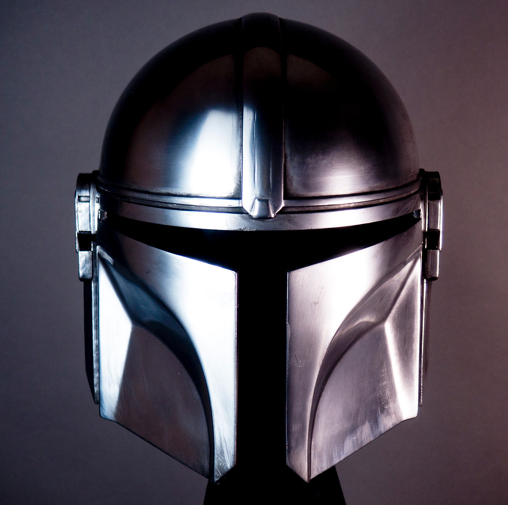

New helmet sculpt from @Do3D is perfect!

What paint did you use to achieve that mirror shine? Looks awesome
