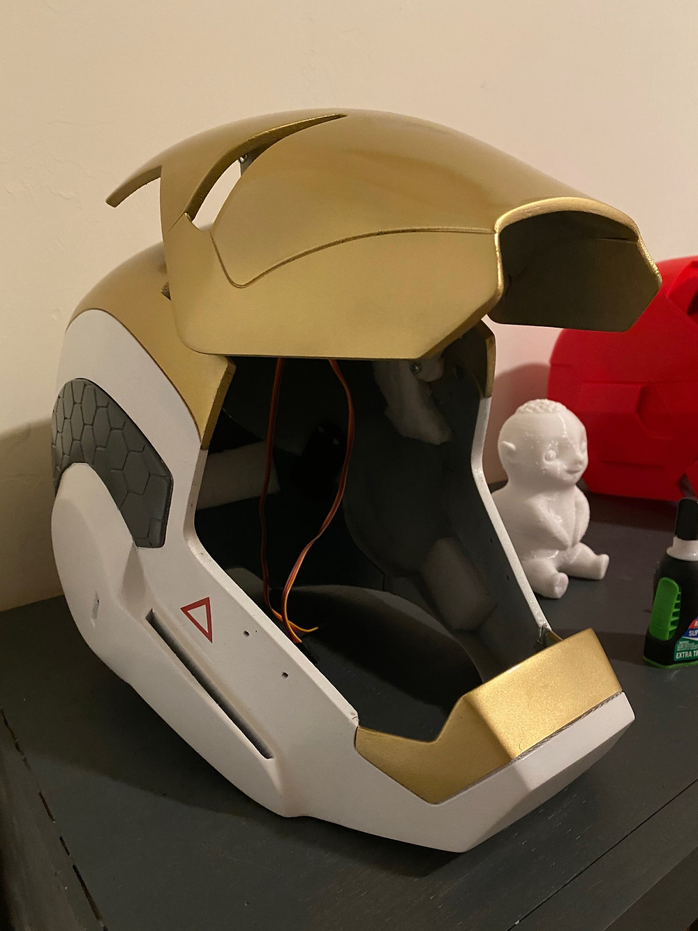

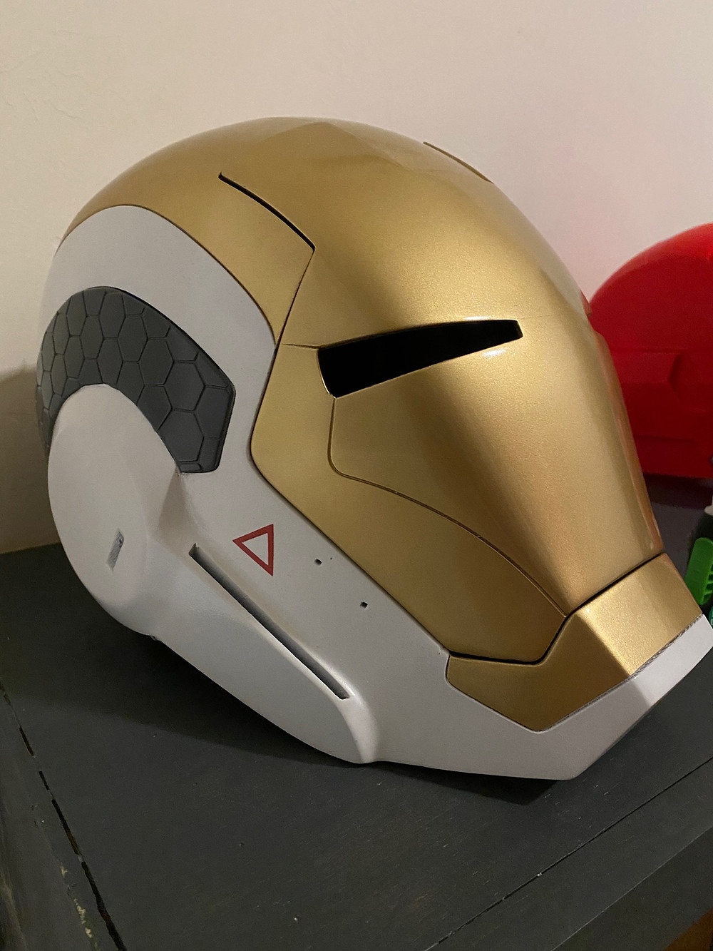

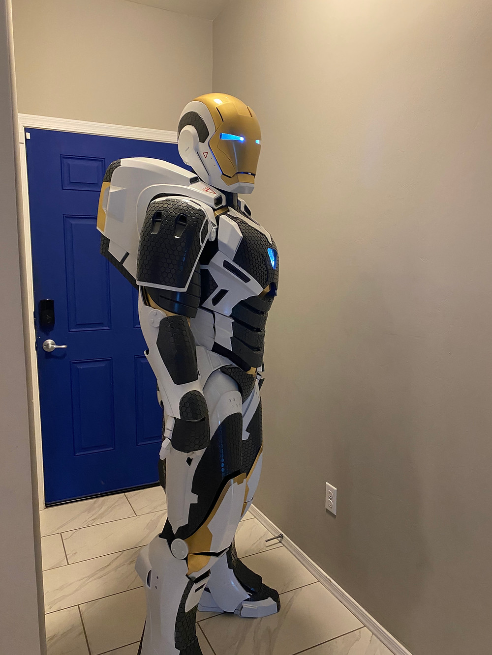

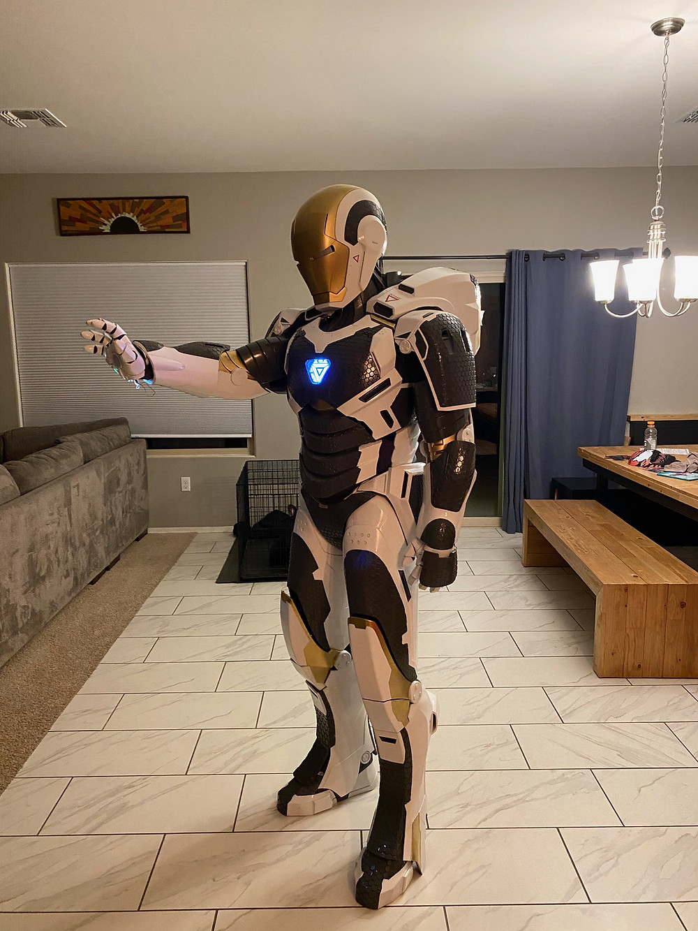

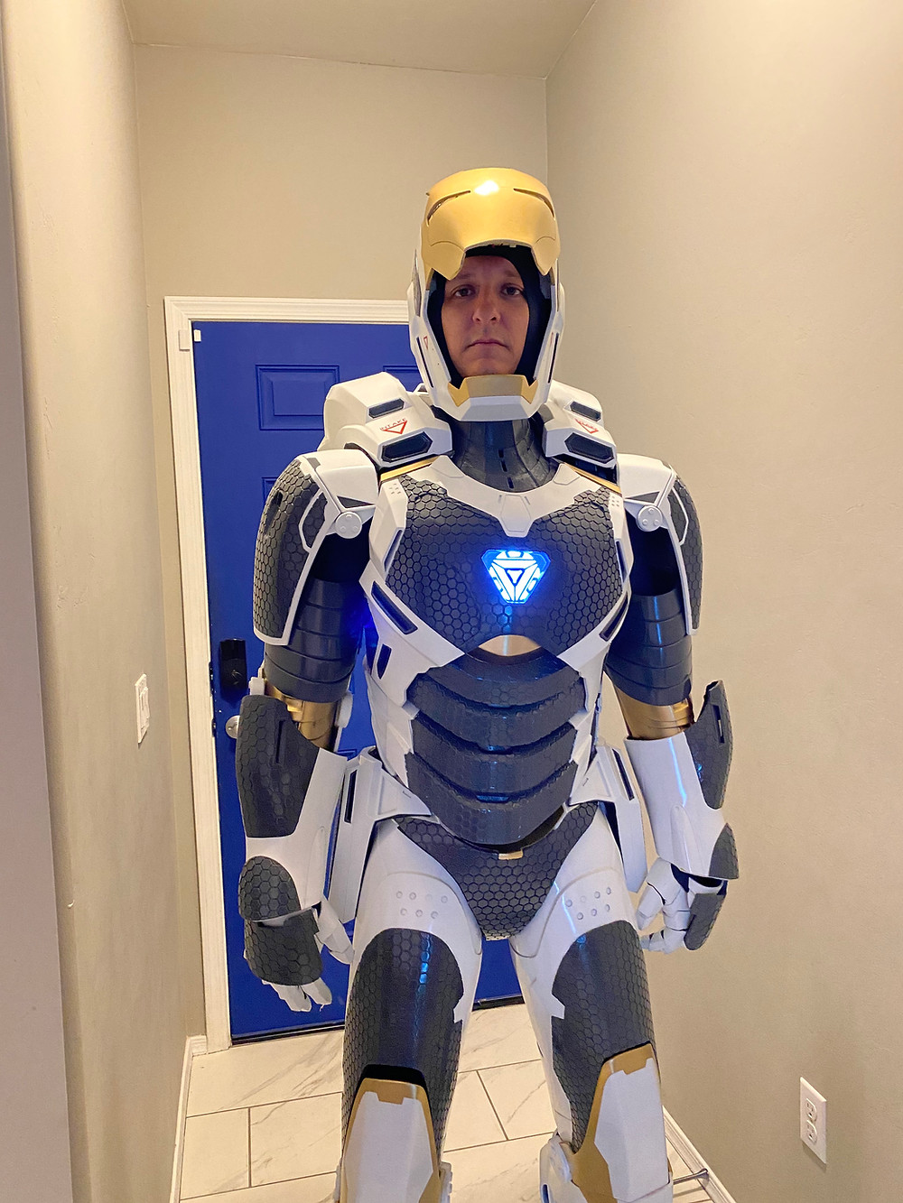

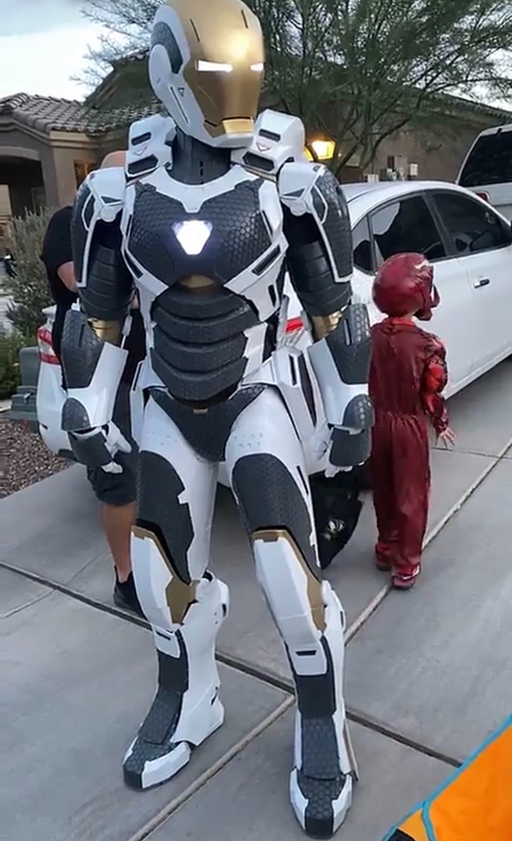

Finally got it finished to the point where I was able to wear it for my companies Halloween costume contest (and yes I won). This has been a 4.5 months long journey from start to where it is now. Still have some things I would like to do like closing up a few gaps better, detail paint the body lines, add additional lights for effect inside the jets themselves, maybe a thruster simulation, etc. But am officially considering this one "done enough" as it stands now. Thank you for this model DO3D as it's been an absolute joy to put together and have loved the journey it took me on.
Short video of movement in the suit.
Quick shot of what the helmet looked like on and in the open position.

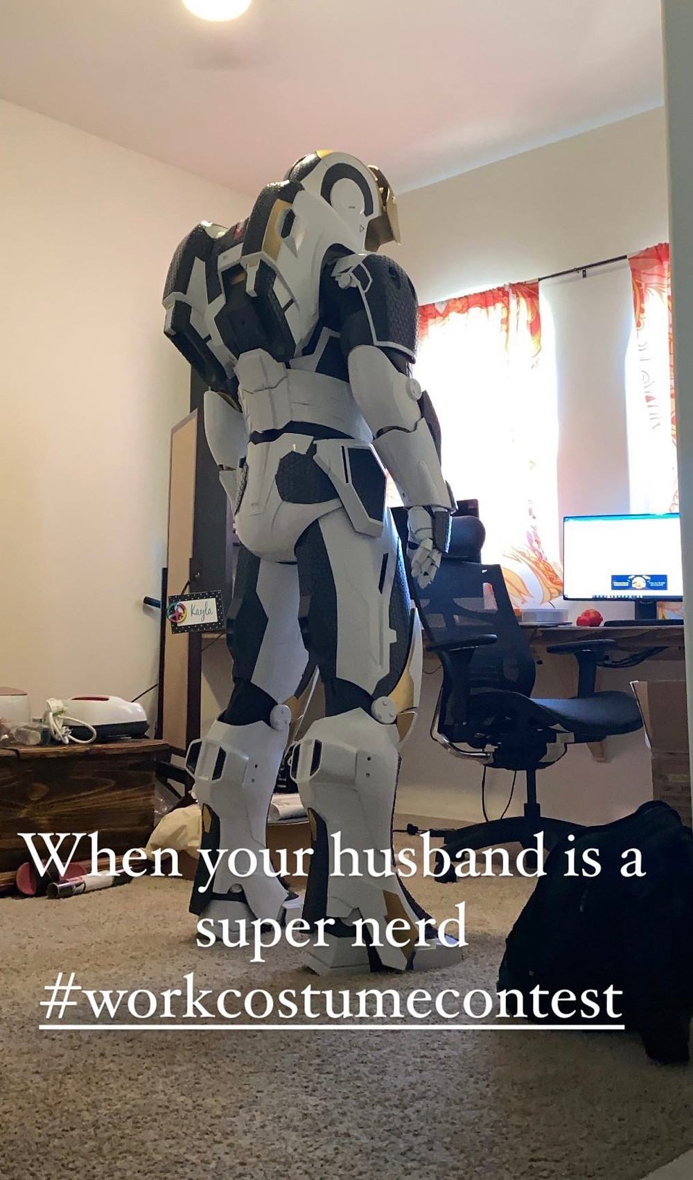

You'll have to excuse the commentary at the bottom of this one, but it's the only pic I have of the backside of the costume that my wife took while I was doing the remote contest at work. Haha

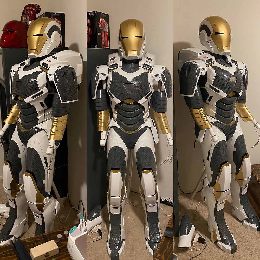

Almost have it all together. This weekend I managed to get the majority of everything painted and back on the stand. Waiting on the hands to finished drying so I can put them back together. Still have to attach the forearms to the rest of the armor. Working on wiring and Arduino programming over the next day or two and then it should be ready for Halloween. Afterwards I plan to do the detail painting of all the body lines and fix any issues that I may come across from wearing it on Halloween night. Figure an hour or 2 in it with everything running will shed light on improvements still needed. But overall, super happy with how its coming together thus far.
Decals made using a Cricut, freshly installed just moments ago. May end up painting these on using negatives later, but decals were the quick way to get them on in time for Halloween.
Full body shot, just missing the forearms, elbows and hands. Still need to install the arc reactor and eye lights, have them just didn't install until I have my code fully working for them.

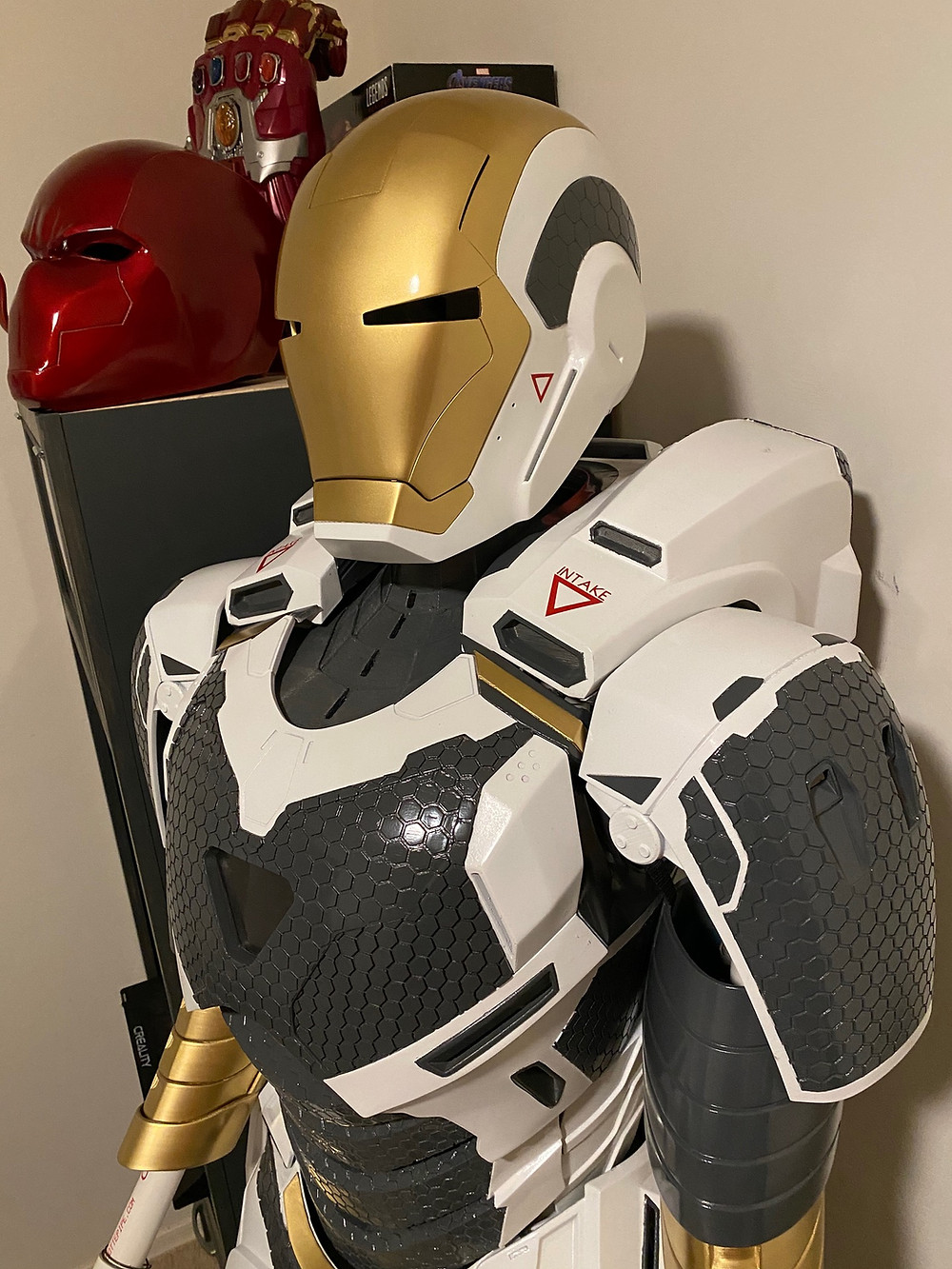

Close up of the helmet, is the only part I have fully sanded and painted.
