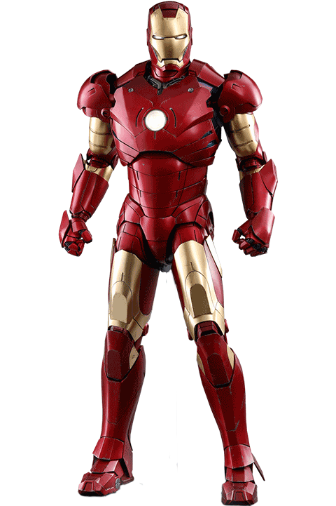

Just look at that waist line. Those shoulders. Anyone else feel self conscious?
This is what you want. So you buy Armorsmith or start measuring in Meshmixer or S3D.

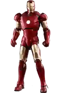

At that moment i made the crucial decision to not scale my armour at all. I would print everything at 100% scale to the original perfectly proportional model which is roughy 6ft tall (not including that weird backpack thing that got less screen time than Black Widows Sandwich)
To me, this was the only way i was going to get these proportions right with my build. Because turns out? I fit perfectly in the upper half of the suit at 100% scale.
Hey look, it's MOSTLY Iron Man!
