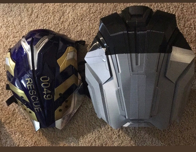

For this build, we've selected House of Kolor after the success we had with Rescue.
The base coat is Apple Red Kandy from their Shimrin Kandy Paint series.
The silver accents will be painted in Orion Silver, a metal flake

June 2020 Progress Update:
We've got most of the main suit parts printed. Here's some details of our progress.
Chest, shoulders, back printed and held together with gaffer tape for fitment.
Chest, shoulders and ab section test fit:
Initial sanding of layer lines with 120 grit sandpaper using electric palm sander.
Plastic welded and bonded with PLA Gloop.
Next to Rescue's back piece for scale.
